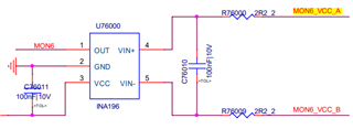

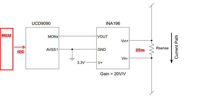

1、电流监控设计如下图,采用UCD9090+INA916的方式,采样电阻是20毫欧

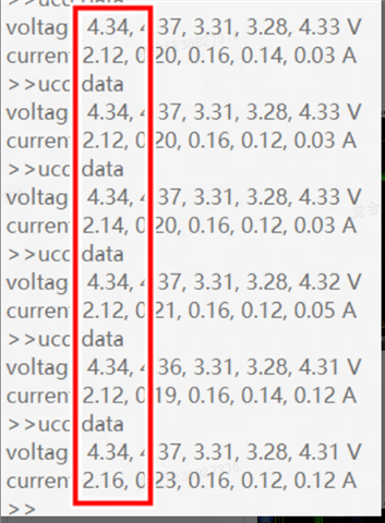

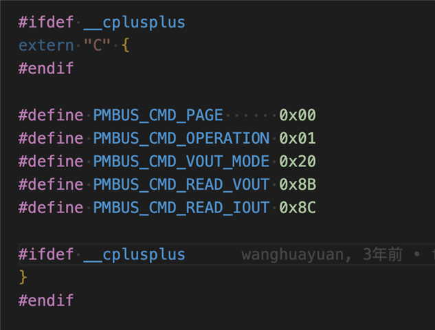

2、当负载电流1A~3A的时候,MCU通过I2C获取UCD9090的电流基本吻合,当电流增加到4A的时候,MCU通过UCD9090获取的电流只有2.3A左右,但是通过上位机(Fusion)读取的电流是4A左右,与实际电流基本吻合
3、MCU是通过读取UCD9090寄存器0x8C获取电流值
为什么MCU读取0X8C获取的电流值有问题,而上位机获取的电流是OK的?

    Since the correct current is being logged by the device, shown by Fusion getting the correct value from 0x8C register, I suspect something is wrong with how the MCU is requesting or decoding the data over I2C.
    When using I2C to read 0x8C, make sure you send request to read 2 bytes.
    Can you provide the format being used by the MCU for this transaction?
    Troy

    1、When using I2C to read 0x8C, make sure you send request to read 2 bytes.
        yes,I confirm that the read request is for two bytes

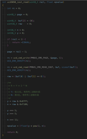

    2、Can you provide the format being used by the MCU for this transaction?

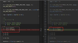

    Can you send the values of buf[0], buf[1] and the corresponding decoded value using your code? 0x8C register is linear11 format, and I want to check if your code is decoding this format accurately.
    Troy
  • Hi~THANK YOU
    1、The issue of the MCU reading abnormal current through I2C was indeed caused by incorrect data decoding. The problem was resolved after modifying the code.

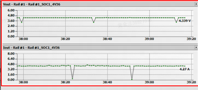

    2、Another issue we found is that when the host computer(Fusion) reads the current, there are occasional instances where the current is zero. What could be causing this?

    Can you provide your schematic and device configuration file (.xml exported through Fusion) to help us determine the cause of the zero current reading?
    Troy
    You said in your initial post that the sense resistor for the INA196 was 20 milliohms, but in the schematic there is a 100nF capacitor shown in between the VIN+ and VIN- pins instead.
    Can you confirm the current sense setup uses the appropriate sense resistor? If so, can you probe the voltage going on to the MON pin when the zero current occurs?
    Troy
  • Hi
    1、The sensor resistor is 20 milliohms. The schematic of the sampling resistor is on another page. See the figure below. It's just that the schematic I sent does not include the sampling resistor.
    2、I will try to probe it.

  • For example, when the load current is around 3.25A, the current collected by the host computer(Fusion) is shown in the figure below. There are occasional instances where the current is zero. The voltage of the sampling channel (MON6)in this circuit remains stable at around 1.3V.
    It seems that the voltage of MON6 is normal. Does the host computer (Fusion) require any special settings?
    Since the voltage is steady, the zero current instances are likely coming from a communication issue where Fusion attempts to read the current but receives an I2C NACK or invalid data for that polling cycle.

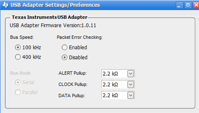

    You can try changing the polling time in Fusion (currently set to 250ms), to see if it affects the number of zero instances. I assume you are using the TI USB adapter to connect to Fusion? You may change the settings on your USB adapter to use 100kHz and disable PEC, to see if that resolves any communication issue that is present.
    Please also tell me what version of Fusion you are using currently.
    Troy
  • 1、changing the polling time in Fusion (currently set to 250ms), to see if it affects the number of zero instances
    -----100ms  1000ms,it did not produce any impact.
    2、You may change the settings on your USB adapter to use 100kHz and disable PEC, to see if that resolves any communication issue that is present.
    ----it did not produce any impact.
    3、i am using the TI USB adapter to connect to Fusion,the version of Fusion is7.6.1
