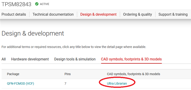

can you please share CAD symbol, footprint and 3D step file for the component?

    The 3D step file can be found on the product web-page under the Ultra Librarian link:

    The footprint for Altium does not seem to work! I have downloaded the footprint from Ultra Librarian by clicking the link in the product page. However, the footprint for KiCad is fine. Do I miss something?

  • I am not Sergey, yet I have used Altium 18.0 and selected these options in Ultra Librarian
    • Basic view,
    • Altium designer
    Then, I clicked File->Run Script, then selected PrjScr file and then the text file to generate the pcblib and schlib files. schlib file is ok, however pcblib file shows nothing. I dont know if there is something wrong with my Altium version, since I do not use the latest version.

  • Ahmet,
    while waiting for feedback from the experts, you might want to check the instructions provided in file ImportGuides.html, which should be part of the downloaded zip file.
    I quickly tried with Altium 23 and first the pcblib did not show anything, but after clicking the "Panel" button located in the lower right corner, I chose PCB Library and selected the listed footprint. After that it was showing the footprint.
    Let me know if this could help you.
    Andreas.
  • Hi Ahmet,
    the expert team confirmed the files imported from Ultra Librarian are OK. The visibility of the footprint is related to Altium. You need to select the footprint from the PCB Library window.
    You could also directly open the .PcbLib file in Altium to view the footprint.
