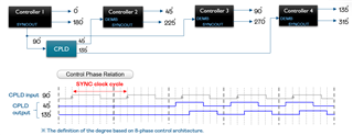

The figure is attached as below to show the connection of 8-phases control architecture we designed,  4 pcs of controllers are needed for our application case,
       After our experiment, the activity of LM25143 is abnormal. there is not any MOSFET switching activity of each controller.

    One thing to note is that Cdith can be removed from each controller and dith be shorted to ground to disable dithering.
    Additionally can you please confirm what the CPLD block is meant to do? Does it take the input from Sync out and output a clock signal 45 degrees and 135 degrees lagging from 90? Or does it create the two clock outputs, one 45 degrees leading and the other 45 degrees lagging from the 90 degree sync out?
    Thank you,
    Joshua Austria
  • Hi Joshua,
         Thanks for your confirmation! I simply summarized the purpose of CPLD block as below,
    (1)  It  take the input from Syncout of the primary controller and then
          create the two clock outputs for 45 degrees and 135 degrees of SYNC signals in 8 phase-control architecture.
    (2)  Since CPLD has to take 90 degrees SYNCOUT from the primary controller first so
           the activity of 45 degrees and 135 degrees of SYNC signals will be delayed for 2 SYNC clock cycles during power start.
    (3) The relation of SYNC signals is one 45 degrees leading and the other 45 degrees lagging from the 90 degree sync out during normal operation.
    I attached a timing chart as below for your reference.

  • Hi Harvey,
    I will have to check internally with the team if this is ok. Before I ask however, is there any way to capture the waveform of the CPLD signals and show them compared to the output clock of the primary controller on the bench? If the oscilloscope can capture this data I want to make sure that the signals that are stated to be coming from CPLD are sufficient and able to drive the DEMB pins of the secondary devices.
    Theoretically, I believe both cases are valid to control the 8 phase controller, but I will check internally as well to confirm this. I believe your system is currently designed to employ case 1. Is there a reason you are interested in evaluating case 2?

  • Hi Joshua,
           Our system is currently designed to emply case 1. The waveform of the CPLD signals is attached below for your reference.
           Since the operation condition example described by LM25143 specification is a primary controller plus a secondary controller so we just would like to know which is the correct condition,case 1 or case2 ?  If case 1 is the better case, we will choose case 1 for our design.

  • Hi Harvey,
    There should not be much of a difference between either case. We recommend debugging with one controller first to see if you can get that working. Once you have the results from one controller, I would be happy to review the resulting waveforms with you. From there the plan is to increase the controller count to see what the issue may be.

               Before debugging, I would like to confirm whether the connection method of our design is correct theoretically,
    especially the schematics of case 1 I shared 3 days ago. you can also refer to the attachment below.

  • Hi Harvey,
    From our perspective we do not see any issues with the schematics of case 1 that was shared before. Theoretically, it looks to be fine but there could be layout issues or some other issue we are not able to see from the schematic view that is causing the devices to not work.
    I will reaffirm that we recommend the debugging steps as listed above to ensure the device operates properly with a single controller, so we can begin to determine the root cause of the issue.
