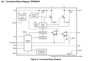

Could you please let me know the maximum output current of TPS63070?
The maximum output current is 2A in buck and boost in datasheet. And  Figure 15, 16, 17 and 18 shows output voltage drops at Output current = 2A. I believe there is a current limit function besides short circuit function but I cannot find the explanation in the datasheet.
Could you please let me know about below?
1. Which point does it check for 2A over current limit in the block diagram?
2. What is the condition for the 2A output current?
Block diagram shows the current sensor for measuring drain-source of the high side FET. I guess it works for 2A current limit. Could you please let me know the current sensor condition/criteria to detect Over current status of the current sensor?
