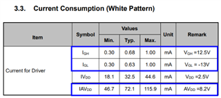

Hi AE,
       I plan to use this IC to implement a boost converter with an output of 8.2V and support for 115.9mA current.
       May I ask what potential risks might arise?

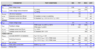

  • Hi Bruce,
    It seems quite enough margin for the device.
    Assume the input is 3V and calculated input current is 8.2V*0.1159/0.9/3=0.352;
    The device has about 3.7A current limit and is quite enough.
    TLV61047 is also optional one.
