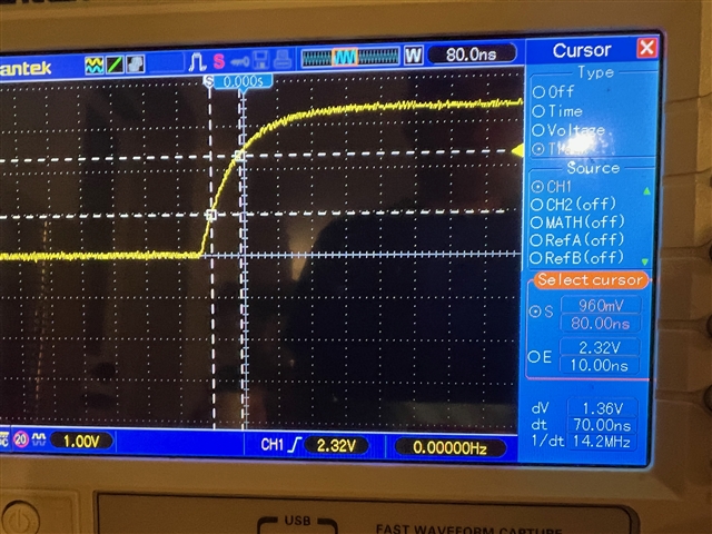

Issue 2:
I am unable to communicate at a 400kHz I2C speed.
When using BQSTUDIO (version 1.3.127) and EV2400 (version 0.32), 100kHz communication is functional as expected. However, switching to 400kHz causes BQSTUDIO to crash.
Conversely, when using my MCU, 100kHz communication is successful, but no response is received from the gauge at 400kHz.
Work Completed:
The XL bit in the SBS Configuration has been set to enable 400kHz mode (as outlined in the attached .gg file).
Additionally, signal integrity and bus capacitance have been verified, and they appear to be within the specified range for 400kHz mode.
The scope has measured a 200ns rise time and a 20ns fall time for the full range, and a 70ns rise time and an 8ns fall time between 0.3 and 0.7 of VDDIO with minimal ringing at the edges. This measurement was obtained while communicating successfully with my MCU at 100kHz.
