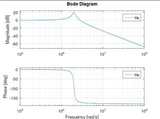

I found that peak at 300kHz suspicious. I then noticed Sn > Se:
Notice values of output capacitance and inductance ( 5.6uH and 50uF) are typical for Vin, Vout, Iout, swiching frequency and ripple current of 30% (ish).

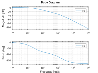

I made Se = 5*Sn just to see what happens and this is what I get:
For comparison, this is the bode plot of He(s) for TPS61175...
..., the bode plot of He(s) for TPS61178 with Sn > Se...
..., and the bode plot of He(se) for TPS61178 with Se = 5*Sn:

  • Hi Elder,
    The calculation is correct.
    1. For the application report SLVA452, I guess the sampling effect He(s) is not calculated it is maybe a mistake.
    2. When slope compensation used, it influences the converter power loop model.
    Here are two situations:
    If Sn>Se, the Gps is no longer the pole-zero-pole form anymore. (Equation 1 in SLVA452)
    the power loop becomes zero-LC double pole -RHP, please refer to Practical Feedback Loop Analysis for Voltage-Mode Boost Converter
    The sampling effect He(s) still exists and is as you calculated.
    2. When Sn<Se, the Gps can be used as Equation 1.
    And the He(s) looks like a LC double pole.
    Please tell me if you have any questions.

  • Hello, Fergus.
    Thank you for your comments.
    However, looking at the equations for Se and Sn I can't help thinking there is an error in TPS61178 data sheet for Se. Please bear with me.
    The calculated values for the input parameters of my design are:
    >> Se,Sn,Se/Sn
    Se = 1595.1
    Sn = 1.4821e+05
    ans = 0.010762
    Sn is two orders of magnitude greater than Se.
    To make Sn<Se we would need to:
    • Reduce L two orders of magnitude
    • Increase fSW two orders of magnitude
    • Increase 1/(1-D) two orders of magnitude, i.e., make Vin >> Vout
    In other words, based on the above, it seems to me TPS61178 would never work in peak current mode control in typical applications.
    The only scenario where Se would make sense is if the unit of Rdson_ls in Se equation is miliOhms instead of Ohms. Any chance is that the case? If affirmative, it breaks consistency with other equations and it should be stated in the data sheet or make the constant 60 instead of 0.06.
