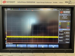

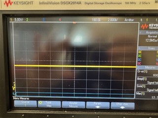

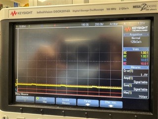

I have a BQ25672 who doesn't work, it can communicate with the mcu but the voltage in the SYS pin is at 0.5 where it is at 7.5V in other pcb. the fault_status0 and fault_status_1 register are at 0x00. I don't have a input voltage read by the mcu but i have activate the ADC.
this is the register for charger_status read by the MCU:
Charger_status_0 = 0x0F
Charger_status_1 = 0x0A
Charger_status_2 = 0x40
Charger_status_3 = 0x00
Charger_status_4 = 0x10
I have this scope
SYS pin
pmid pin
SW1 pin

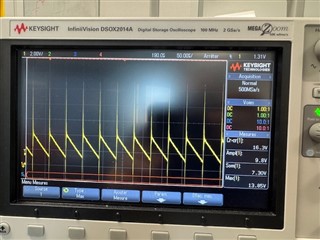

for a pcb who is good, sw1 is thi screen:
