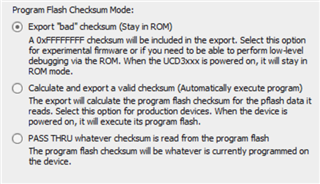

Dear,
I got a problem on UCD3138064 when I used the FusionX0ToHext to convert the X0 file.
I solved the UCD3138128 via the FusionX0ToHext to convert the X0 file.
https://e2e.ti.com/support/data-converters-group/data-converters/f/data-converters-forum/1439304/ucd3138128-ucd3138128?tisearch=e2e-sitesearch&keymatch=UCD3138128#
Now I would like to confirm whether the commands I entered for UCD3138064 are correct.
"--infile test.x0 --pflash-checksum calc --export both --format intel --outfile file.hex --ic-family UCD310064 --flash-block-size 64"
Because the checksum in the hex file I obtained through the FusionX0ToHext is different from the one produced by the customer using the TI tool(Fusion Design Online).
