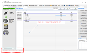

3) My customer uses the detection resistance of the actual 4 mΩ, but the EVM is 10mΩ.
Calibration is performed after writing the GF obtained from the demo board.
At that time, the values of CC delta and CC offset are about 4. In this state, the error that CC delta is over the settable value appears. Is the detection resistance of 4mΩ not supported?

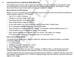

    The ChemID is #0815.
    The battery is used in 2 series on a 12V (FML12170) Lead Acid Battery.
    1) I am looking for document to do the learning cycle.
    I found the following document on the web. Can my customer do the learning cycle correctly if I do it with reference to the following part?
    4555.How to Complete a Successful Learning Cycle for the BQ34z100.pdf
    2) I think the Learning Cycle is charged and discharged twice, but the lead-acid battery deteriorates significantly in the first floor charge and discharge.
    Is it OK to shorten the relaxation time to an hour?

    4) My customer uses the detection resistance of the actual 4 mΩ, but the EVM is 10mΩ.

    1) BQ34Z100-G1 Technical Reference Manual (Rev. A) Chapter 11 in the trm has a better learning cycle steps in my opinion.
    Here is a more general document. Achieving The Successful Learning Cycle
    2) The battery needs to be fully relaxed before proceeding with the learning cycle process.

    4) They need to send the cal_enable cmd and enter_cal cmd. I recommend using the calibration tab on BQstudio.
