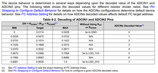

7. For the battery is double battery 8.4V, the input needs to support 9V/3A,5V/3A, the external output supports 5V3A requirements, how to connect the ADCIN1,ADCIN2 circuit

    7.TPS25751 charging state (input 9V/3A,5V/3A), external charging (5V/3A), then how to configure ADCIN1,ADCIN2 this, how to set the external resistance?
    ADCIN1 and ADCIN2 are resistor divider settings to configure TPS25751 I2C target/device address (0x20, 0x21, 0x22 or 0x23) as well as its dead battery configuration (how the PD behaves when it's first powered through VBUS and a config hasn't been loaded yet). See screenshot from the datasheet below showing how the resistor divider value is decoded:
    Refer to my previous response for question 7. The dead battery configuration is dependent on the behavior desired for TPS25751 when booting up in dead battery mode and if the PD configuration is loaded from EEPROM or MCU.
