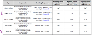

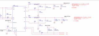

HI,farheen i have another question for this product.
We designed it like above picture.
Can you recommend option for this picture?
I want to choose 1 or 2. 1 is only using 7uF , 2 is good at transient reponse.
could you recommnend 1 or 2 by considering our usecases voltage and current?
In addition, i want to know exact output capacitance value and reason.
Hello Lim,
It depends on what is your transient target. If it is somewhat like 3-5% then I will recommend comp 2.
Farheen
Hello Lim,
If you are looking for regulation of around 5% of Vout then you will need higehr capacitance. I can not give you the exact value as this is something you can check on the EVM but using compensation 2 with higher capacitance helps mostly for tigher ouput voltage regulation specs.
