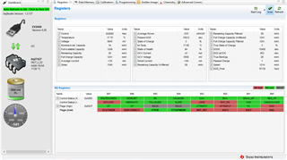

I am using BQStudio to create a profile and have connected the I2C lines to the test pins of our MCU. During the charging or discharging phases of the learning cycle, I encounter a WDRESET. What could be causing this? The MCU is not running and remains off.
One strange behavior I notice is that BQStudio reports a lost USB connection to my EVM2400. Afterward, I need to restart BQStudio. Since the connection is via I2C, could this be interfering with the watchdog timer? Any ideas?
Another topic is that I am not reaching 100% during the learning cycle. The state of charge stays at 99%.
The battery is from Jauch. Before starting the cycle, I set the chemistry ID to 0x1202 (4.2V) and then change it to a similar chemistry ID   afterward.
I only adjust the design capacity and energy; the rest of the parameters remain at their default values.
Any ideas? The taper rate and thresholds seem fine to me.

  • Hello Jonny,
    I figured it out—it has something to do with the WDReset. If it does not occur, I can reach 100%; otherwise, the chip resets its value.
    When the WDReset is avoided, the learning cycle is successful. Could a WDReset be caused by disturbances on the I2C line? Also, can I upload the unmodified logfile from BQStudio for GPC?
    Another question: How can I ensure that when configuring a new fuel gauge for another MCU, I don’t need to perform the learning cycle again? For example, is it possible to make the fuel gauge show 100% directly after its first charge?
  • Is it normal for bq27427 that it shows negative current when its charging? Because the DSG bit is set (DSG = Discharging detected. True when set.)
    Is this my problem? I am testing with  BQ27427EVM-037
