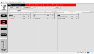

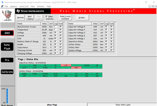

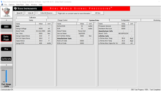

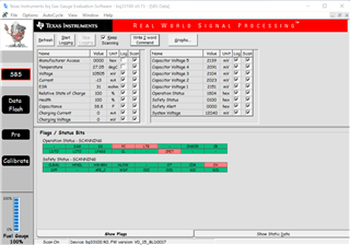

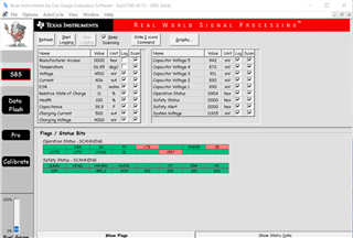

We included a P-FET for pack charging control, but the BQ33100 is not turning on the P-FET even though sufficient power is available to the board. I tried checking the registers through a terminal (BQ33100 i2c is connected to Toradex iMX8 SOM) for any faults, but no faults were observed.
I found a similar issue in this TI forum thread, which suggested a file update might be necessary(https://e2e.ti.com/support/power-management-group/power-management/f/power-management-forum/1006869/bq33100-p-fet-is-not-turning-on-when-power-is-availble)

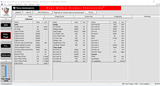

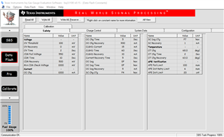

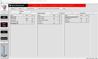

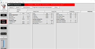

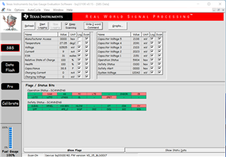

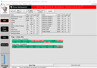

For that, I connected the board to EV2400. Initially, I connected only SDA and SCL, which resulted in no device detection. Later, I connected the board ground (GND) to VSS of EV2400, and then the device was detected, but a "VB_T2H_NACK" error occurred. How can I overcome this error?
