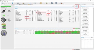

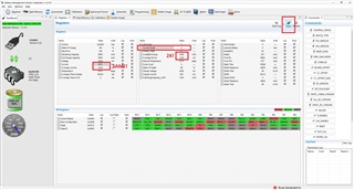

    Here is my procedure:
    Connect the BQ34z100 to bq studio. no problem, all values are updating. scan is enabled. current scale is 1.
    Change current scale to 2 on the data memory tab. return to the Registers tab, current scale now reads 2.
    The reported current remains unchanged, but both average power and available energy have been multiplied by 2, proving that current scale was changed in flash.
    I have attached 2 screenshots to illustrate.
    currscale is 1:
    currscale is 2:

  • Hi Steve,
    Respectfully, this behavior is not seen on my end. When I change Currscale to 2 my reported current is halved.
    I have report this to SQM for further analysis.
    Is your system discharging more than 32A, if not current scale is not needed.
    Diego
