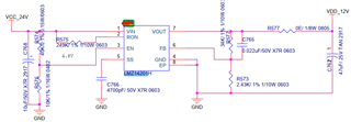

I have did a design with LMZ14201H , Input from 24V and output is 12V/ Max <1A current.. But without any load, if I power on, then output voltage is 16V in DMM in scope its actually fluctuating. When I check the feedback its 2V in DMM and Enable is 1.6V , I dont know what is happening, I have replaced IC,replaced the SS cap, nothing is working.
, I removed the input cap then also i checked ;no change,
What could be the problem here?
