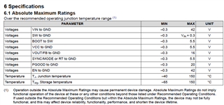

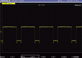

My customer concerns SW node undershoot during operation of LMR43620-Q1 as this exceeds abs max rating (-0.3V).
I believe there is no concern because this is just a body diode voltage drop during deadtime, is it correct?
