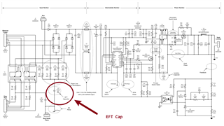

Hi Team

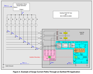

Customer have a circuit that uses the Bob Smith circuit. There is a paper on the TI  website that explained this circuit, but there was an EFT capacitor in it, and a 2kV capacitor was selected here.
The document link is: https://www.ti.com/lit/an/slua469/slua469.pdf?ts=1613488928783&ref_url=https%253A%252F%252Fwww.google.com%252F  Designing an EMI Compliant PoE with Isolated Flyback
Can you help to explain the background of choosing the 2kV withstand voltage of the EFT capacitor here?
When choosing a capacitor here, how should customer choose the package, withstand voltage, and capacitance volume?
Is there any other same function device to recommend?
