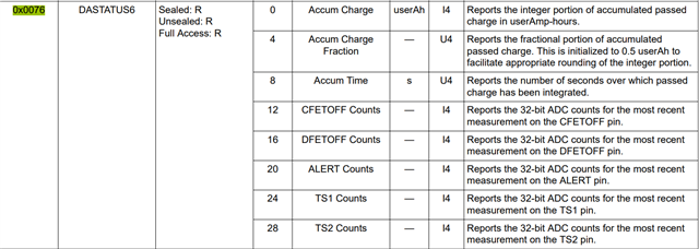

Hi Team,
What could be the possible reason for the sudden change in accum charge of BQ76952 to -32768 during testing?
Hi Team,
Hello Allen,
I found this previous forum post that may be able to answer your question: Accumulated time in DAStatus6 overflows after 32767.
Alexis
