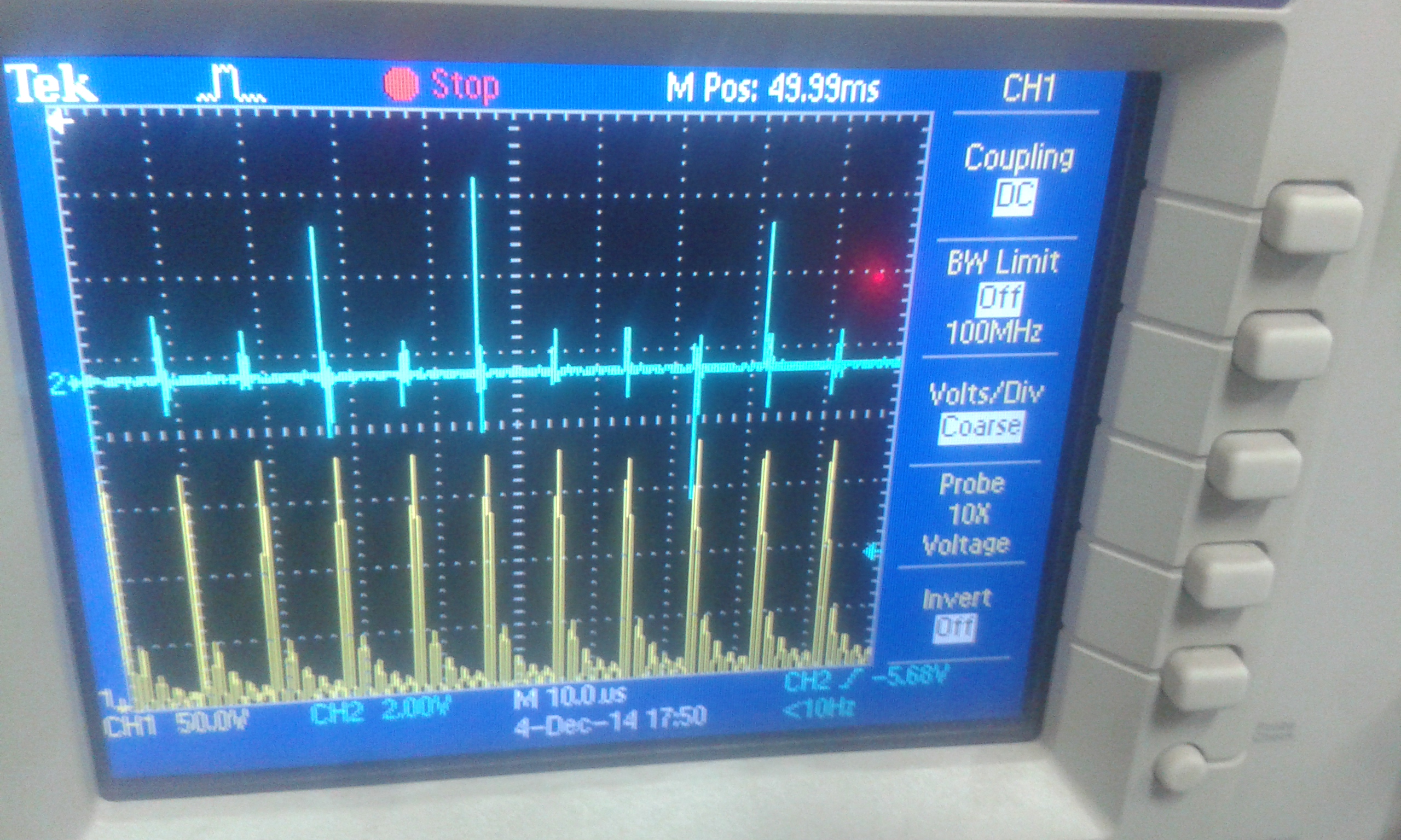

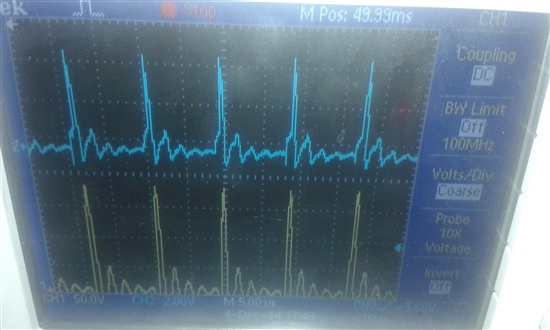

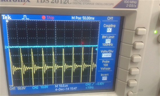

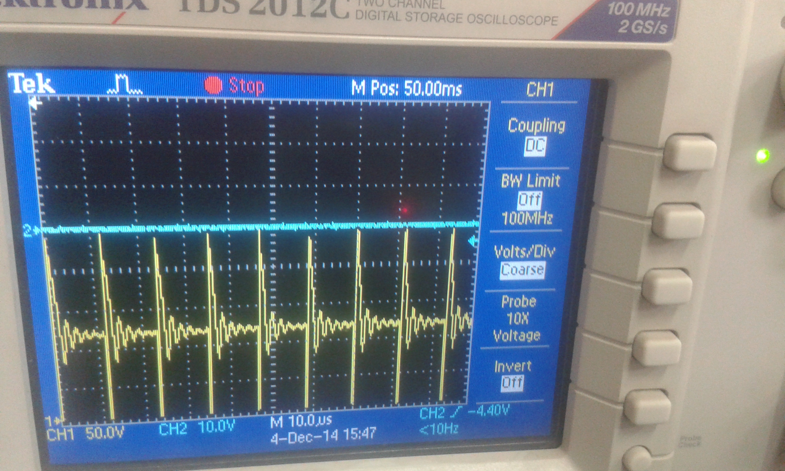

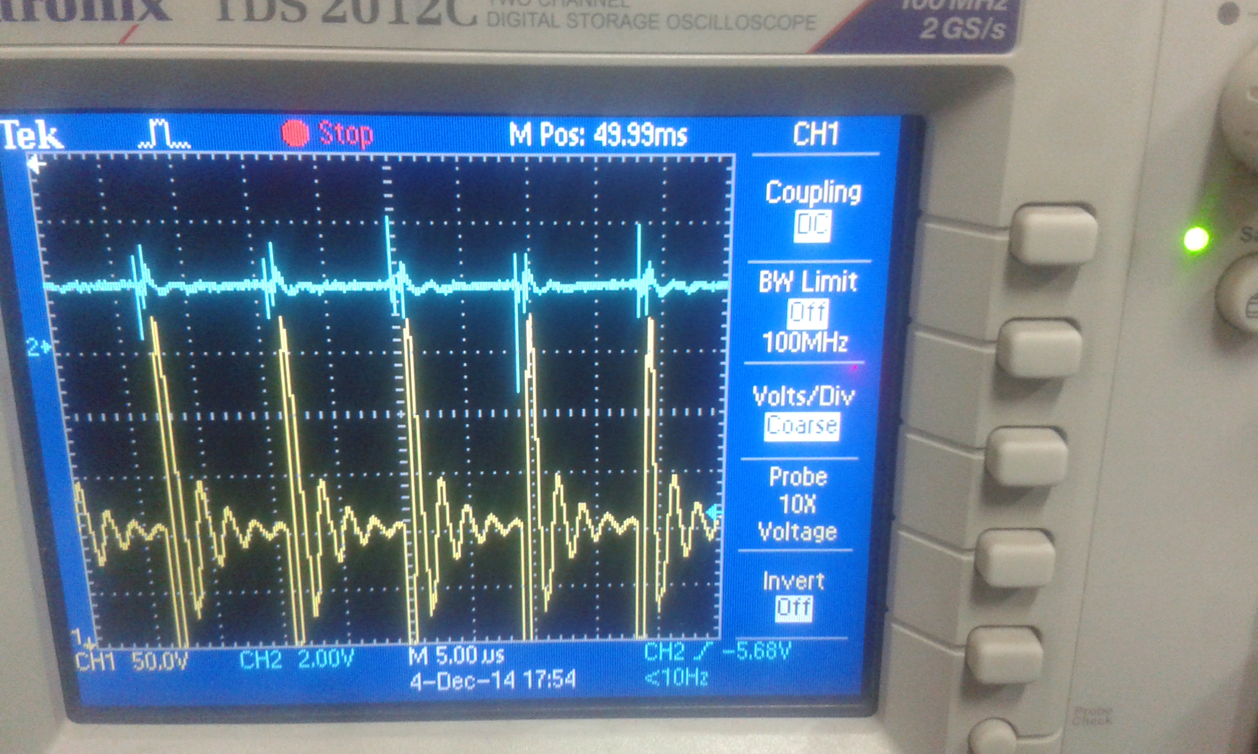

  • hello,
    i am ucc28600 to deliver 5V@10A output,
    the device shutsdown when i increase the load upto 2A,my question is how can i increase the load upto 10A, in calculated values using QR design tool,
    here are waveforms captured at Vin = 110VDC & Vout  = 5V at 800mA load
    i) cs pin voltage- channel 1,RCS = 375mE,RPL =1.2K
      mosfet drain voltage - channel 2
    ii) OVP pin vltage , Rovp1 = 288K,Rovp2 = 44.2K
    iii) mosfet drain voltage
