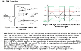

I have the following questions regarding this chip :
Question 1: Is there any way to determine the design margin of OCP2/OCP3 for this chip through testing or theoretical calculations?
    It can be done through testing. All you need to do is use the math function  and multiply the HO (make sure the signal is attenuated such that voltage level is 1 or 0)and ISNS signals and find the average of the math function
