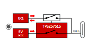

TPS25751: TPS25751 and BQ25756 got PP1 and PP3 switch disabled due to fault
Part Number: TPS25751
Other Parts Discussed in Thread: BQ25756, BQ25756E, PMP41062, TPSM33615
I've swapped the BQ25756E to a BQ25756 as suggested.

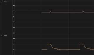

I'm trying to source again at 5V3A and 9V3A.
When a contact has been established, the PD sink sends a HARDRESET due to the sink not being able to power up the VBUS. See picture below.

But when reading out TPS register 0x26 (PD_Status), both PP1 and PP3 faults disable the switches.

When does a fault on the PP1 and PP3 switches occur? Due to overcurrent?
    TI U.S. is on Holiday today. Please expect some delay in responses.
    Aya Khedr
    Type-c state machine is selected as DRP however there are no sink PDOs defined, have you tried to change the state-machine to source only does this match what you are configuring in the GUI?
    I will also review the i2c transactions to confirm the operation.  You mentioned that it works with an MCU, have you compared the I2C traffic?
    The fault may be overcurrent resulting in an under voltage event.

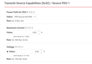

  • Noah,
    In the advanced settings I can see that PP3 is selected as the source for PDO1.  However in the questionnaire the description shows PP1 being used as the 5V power path.
    Are you using the TPS25751D or the TPS25751S?  Do you intend to use the 5V path to source 5V and the external path to source the 9V (the external path will also sink 5 and 9V?)
    Chris
  • Hi Chris,
    I use the TPS25751S, with the TPSM33615 as 5V power source connected to PP5V.
    Since the TPSM cant deliver much current (1,5A max), I will use the BQ (PP3) for 5V power to the VBUS for a 5V@3A power profile. PP3 is also used for higher voltages. (9V3A, 12V3A, 15V3A and 20V5A)
    When using the TPSxS variant, PP3 is seen as PPEXT right?
    I've also tried using PP1 for PDO1, than the 5V PDO will work but a higher voltage PDO wont work.
    Also do the settings in the questionary overrule the advanced settings (or vice versa)? Or do they need to have the same configuration?
    You are correct.
    The advanced settings will overrule the questionarre.
