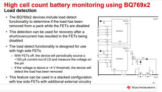

we are stacking two AFEs in our design please help me to connect pack and LD pins for both AFES.
I have seen TI website found a document, but I did not understand that document so please explain in detail. (We are using high side FET)
Please suggest is there any reference designs available
Source: How to stack non-automotive protectors and monitors in high cell count applications.
