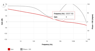

    I quickly checked the Bode plot for TPS546D24A  in WEBENCH Power Designer with the following inputs:
    Vin: 10V-14V
    Vout: 0.8V
    Iout: 22A
    Max ambient temperature:55C
    With optimization that targets maximal efficiency, tool suggest switching frequency of 325kHz and I get the following Bode plot:

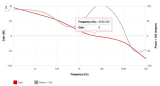

    If I manually change the switching frequency to 1.5MHz, the bandwidth is increased (although the efficiency is decreasing to below 80%) but still is far from 200kHz that you mentioned:
    Could you please advise how to achieve the loop bandwidth that you mentioned in your answer with the same design inputs?

  • Hi Tsvetelin,
    To achieve the desired loop bandwidth, you need to set the VLOOP higher. In Webench, try increasing the VLOOP to 8 within the Compensation Loop Gain settings selectable via pin-strapping. With this configuration, you can expect a loop bandwidth of approximately 200kHz at a 1500kHz switching frequency.
