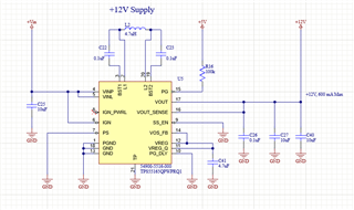

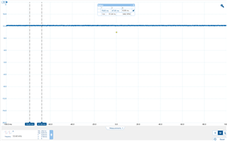

I am using the TPS55165QPWPRQ1 in the fixed 12V out configuration.
This is a copy of my schematic:

I am using the same exact part number inductor that was identified in the EVM board for this part.

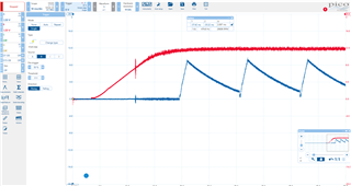

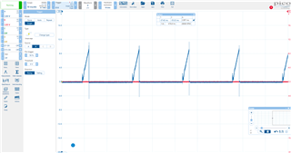

I had three boards prototyped. One works correctly. The output is always 12V when input ranges from 12 to 24V. However, the other two boards do not regulate the output voltage at 12V when the input is below 15 V.

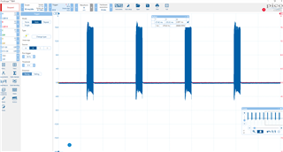

This is a screen capture of the output voltage of the board that is working correctly when the input voltage is 12 V.

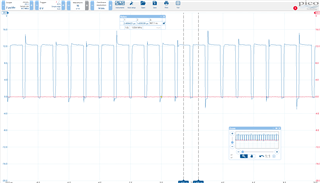

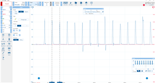

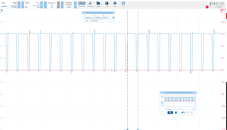

This is a scope capture of the output of one of the bad boards when the input voltage is at 12 V.
In both situations there was no load.
I'm not sure if there was an assembly error or if there is something marginal with the board design that is causing one board to work and two boards to not work. I verified all of the components are correct. I can't seem to figure out what could be different among the boards that I have. I would appreciate any help with troubleshooting this. Thank you.
