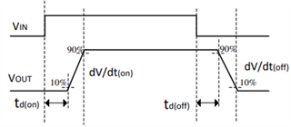

    Having the diode on VS will work fine in this application for reverse current protection. My concern with the ranging duty cycle would be giving the device enough on time for it to be properly enabled. I have attached the figure displaying the switching characteristics of the device.
    With the Tdon/Tdoff and slew rate on/off the total time is around 200us. It would be best to ensure the duty cycle range will allow for this switching time.

    I see. So if my calculations are correct, at a SF of 490Hz, a 1% duty cycle would give us a desired "on" time of 20.4us, which would be too fast. Then at minimum I would need to look into doing 10% duty at the lowest to have a visible "on" state, which would give us an on time of 204us. Is this the right thought?
  • Yes, that is the correct thought. I would provide a larger cushion for the on time and the duty cycle percentage. There will be power stressing during the PWM application that can increase the heat of the device in normal operation. If your application can operate 20-25% that's what I would recommend.
