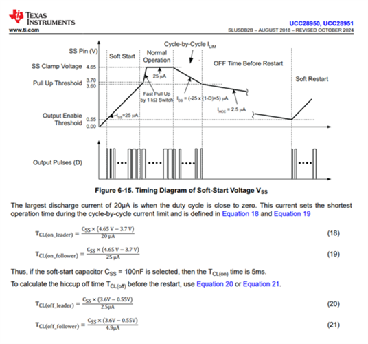

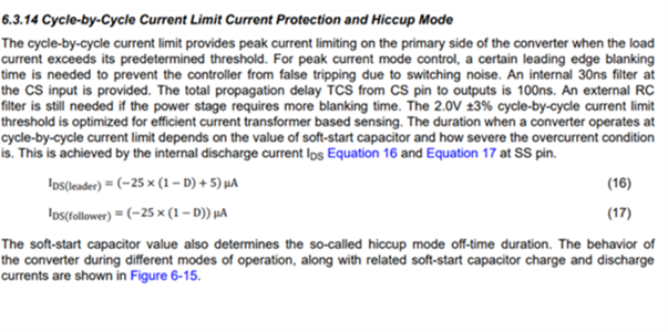

    The cycle by cycle current limit will discharge the soft start capacitance based on IDS.  When the SS capacitor discharges from 4.65 V down to 3.6 V the device will stop switching and enter hiccup mode.  It is not based on the number of cycles but how long it takes to discharge the SS capacitor.
    Please see below for details on how over current protection hiccup mode works.
