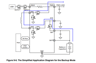

I am designing a UPS around BQ25798 but it is out of stock, is there any similar IC offered by TI?

I looked at BQ25792 as well before selecting BQ25798, the only missing feature is Fast-backup mode and I need that feature in my design, other alternative I looked was bq25730 which have MOSFET driving options so I have to use external MOSFETs with that which complicates my design, it also does not have Fast-backup mode.
It would be good if you can clarify that BQ25792 can provide the fast-backup mode functionality as well.

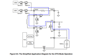

One more doubt, BQ25792 is also pretty much similar to BQ25798 the only difference being the back-up power mode. But can I use OTG capabilities of bq25792 to do fast switching when input source is disconnected?
So it can mimic the functionality of bq25798.

Backup mode and OTG mode are different. Backup mode is simply OTG mode that turns on automatically when input power droops and provides the OTG output back to PMID pin not VBUS pin. So it will be dependent on where your load is.
Christian.
Okay, so BQ25798 have a path leading to PMID, but is it same in BQ25792?
Cause BQ25798 can provide power on PMID in cases of VBUS absence but can BQ25792 can also do the same?

Hello Vailbhav,
Yes, I confirmed you can support a load on PMID or VBUS in OTG mode. Backup up the charger automatically changes the converter's operating direction to reverse/OTG/source (from forward/charge/sink) so that the battery can provide a regulated voltage at PMID. If you are okay with manually turning on OTG mode when adapter is removed, then BQ25792 will work.

How long does the mode switching takes? cause in my application i need switching in few milli seconds

Hello Vailbhav,
Then I would highly recommend using BQ25798 with backup mode. OTG is not meant for fast switch over.
In OTG, you have to wait for VBUS to drop below VBUS_UVLO, Then send a command to enable OTG, Then wait for the converter to start up (around 5ms).
