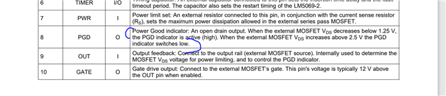

  1. Can the LM5069 replace the LTC4231 and LTC4365 for the above applications, particularly in the context of controlling external MOSFETs for the Kill-Switch function?
  2. For the LCL functionality, does the PGD pin (Pin 8) of the LM5069 reliably indicate the ON/OFF state of the distribution lines? If not, would you recommend another method or component to achieve this status feedback?
