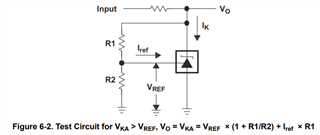

Hello Team,
we were using TLVH431A for our new development. what will be the minimum cathode current when the Vka>Vref or Vka=Vkamax ?
because as per below image in datasheet it is mention only for the case of Vka=Vref what will be the minimum cathode current more than Vref voltage for regulation of TLVH431 ?
because most of the tests are done with the 10mA cathode current and Vka=Vref. we are interested in the minimum current required for regulation when Vka>Vref.

  • Hi Jayjit,
    Thanks for your question!
    The minimum current required for regulation when Vka > Vref stays the same as I_K(min) shown above.
    However, the circuit will need to be adjusted such as the following:
    It is still recommended to have Ika > 100uA to ensure that the device turns on properly.
    I hope this helps!
