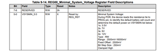

    1) which one should we consider as the main output?
    SYS is the main output. If VBAT<VSYSMIN, VSYS=VSYSMIN. If VBAT>VSYSMIN, VSYS will be slightly higher than VBAT. If reliable input voltage is detected on VBUS, PMID=VBUS.
    2) And if we want a 5V output, how can we set the voltage of main output?
     VSYSMIN can be set in REG0x00. This is the minimum value of the VSYS. As the battery voltage increases, VSYS will rise to be slighty higher than battery voltage
    3) Does it provide a default 5V output?
    No, The default value is based on the resistance tied to PROG pin.

    Please see my reponse from your previous thread:e2e.ti.com/.../bq25798-when-is-the-pmid-supply-used
    If you are using an Input voltage of 5V and a battery voltage of 3.7V, I would recommend using PMID as the system load. PMID will equal VBUS when in forward mode(5V). In reverse mode it will equal to the OTG voltage, This can be set to 5V in REG0x0B
    In your case the reason why I would not recommend the SYS pin, is that VSYS_MIN should not be set greater than the max battery voltage. If you are using a battery voltage of 3.7V, VSYS should not equal 5V.
