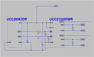

    • If possible, would you be able to share the schematic?
      • This can help me check if there are any possible root causes from the schematic.

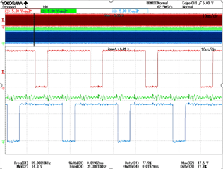

  • Dear Hiroki
    Thank you for your reply.
    >Are there any waveforms you can share of the VCCI, INA, INB?
    CH1:1(INA)-4(GND), CH2:3,8(VCCI)-4(GND), CH3:2(INB)-4(GND)
    I have not measured the waveform at the time of breakage.
    The connection diagram is outlined below.
  • Hi Iura,
    Thank you for following up with the additional details!
    It looks like there is not much noise on INA or INB and the transients in VCCI are well below the 20V absolute maximum specifications. From this waveform, there is nothing indicative of causing damage to the gate driver.

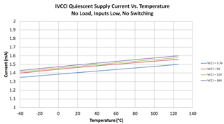

    Here is a plot generated of the VCCI quiescent current across temperature at various VCCI voltage levels. There is not much of a difference at different voltage levels.
    Under switching conditions, if both channels are simultaneously on it will consume an extra 2mA of quiescent current. If complimentary, it will consume an extra 1mA of quiescent current. In your case with the example waveform, it will be approximately 1.5mA of extra quiescent current on top of the value seen on the generated plot.

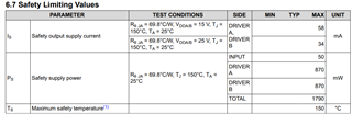

  • Dear Hiroki,
    In case that extra current is added to the quiescent current on Vcc=16V or more, is there a risk of damage by exceeding Safety supply input power 50mW?
    Iura
  • Hi Lura,
    The safety limiting values indicate how much short circuit current is required to damage the isolation capacitor. It is unlikely that the device will ever draw >10mA of continuous input current unless it is damaged. In the damaged condition, if you can limit the short circuit current below 10mA, you can protect your isolation capacitors and still maintain the full high-voltage isolation barrier.
    Sean
  • Dear Sean,
    Thank you for the reply.
    Does this mean that the safety limiting values are actually specified only in terms of current, not power?
    For example, with a quiescent current of 1.5 mA, an additional operating current of 1.5 mA, and VCCI = 17 V, the input power exceeds 50 mW defined as INPUT SIDE Ps.
    (1.5mA + 1.5mA) * 17V = 51mW
    Could this be a cause of failure?  Or is it OK because the input current is less than 10mA?
    Iura
  • Hi Iura,
    You are correct, the safety limiting values should be taking the supply voltage into consideration.
    In your example, it would be surpassing the safety limiting values for input side and would not be recommended for continuous use.
    Hope this answers your question.
    Hiroki
  • Hi Hiroki,
    In conclusion, I understood the following.
    - The VCCI input power must not exceed 50 mW.
    - Therefore, the additional input power must be reduced by lowering the duty ratios of INA and INB.
    Thank you for your help.
