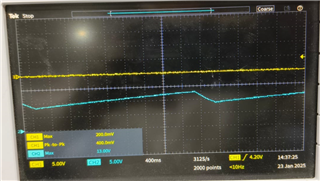

This is the waveform I am observing where the yellow is at the input of UCC5304D in PMP22495 which is AUXILARY AND THE blue one is at Gate of Main MOsfet.

I THINK THE MAIN GATE PULSE IS TURNING OF QUICKLY BUT THE AUX PULSE IS FOR COMPLETE DUTY CYCLE.
KINDLY HELP ME SOLVE THESE.

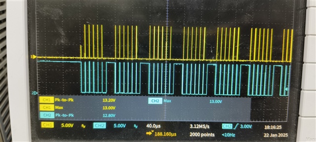

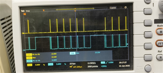

    I MEASURED ITS JUST LIKE THE MAIN OUT PULSE below is of AUX AND ABOVE IS OF OUT.
    AS PER MY OBSERVATION EVEN THOUGH THE FREQUENCY SET IS 100KHZ THE AUX IS SHOWING 200KHZ INITIAL OR ITS SKIPPING ONE PULSE
    .AND IN SS PIN I AM GETTING TRIANGLE OR WAVEFORM GOING FROM 0.6 V TO 2.6V AND COMING DOWN FROM 2.6V TO 0.6V.

    UCC2897A OUT and AUX should have almost the same waveforms on the two pins. The IC looks damaged. You need to change to a new IC to check. Make sure no short or low resistance from OUT to ground

    THE YELLOW IS OUT AND BLUE IS AUX
    IT IS OBSERVED THROUGH 100VDC TO 380VDC .
