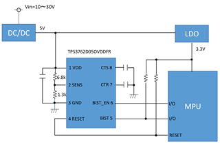

I am currently considering using the TPS3762D02OVDDFR in the attached circuit configuration.
I have reviewed the datasheet, but I would like to confirm a few points to ensure proper functionality.
  1. For the TPS3762D02OVDDFR, should the SENSE pin be set to 0.8V as calculated in the attached circuit?
  2. If I use a variant with a 5V threshold voltage, such as TPS3762DK0OVDDFR, should the SENSE pin be directly connected to the 5V output of the DC/DC converter?
  3. Regarding operation, does the RESET pin initially go High at the minimum VDD (2.7V) during power-up, and then go Low if the SENSE pin voltage exceeds or falls below the threshold?
  4. What does "OV" represent in the part number TPS3762D02OVDDFR? Does it mean "Over Voltage" detection?
  5. Are there any potential issues with the attached circuit configuration that we should be aware of?
  6. Is any pull-up or pull-down resistor required for the BIST_EN pin in this configuration?

  • Hi Conor,
    Please see my answer below.
      1. The desired threshold of the 5V rail should be set as the .8V output of the voltage divider.
      1. If the nominal rail voltage is 5V, I would recommend using a lower voltage threshold device unless a reset assert is desired at 5V.
      1.   At start-up, for the overvotlage monitoring device, if the the monitored rail exceeds the threshold during the reset time delay, the RESET will stay asserted low and will only de-assert high, if the rail stays below the threshold for the duration of tctr.
      1. yes, OV does stands for overvoltage monitoring device
      1. For the pull-up resistors of the RESET and BIST, I would recommend using a 10kohm. Other than that the schematic looks good.
      1. No requirements. A pull-up or pull-down may be required if MPU GPIO is at unknown state during start-up.

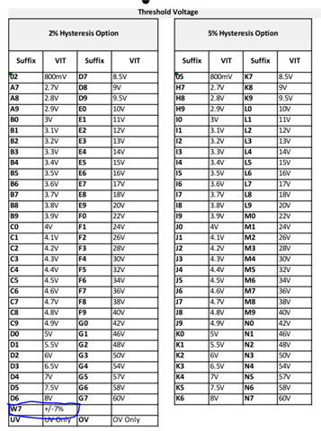

    Q1.
    I am reviewing the TPS3762 datasheet and noticed that the specific threshold voltage (VIT) for the "W7 ±7%" setting is not explicitly mentioned. Could you please clarify what baseline threshold voltage the "W7" setting is based on, and provide details about the exact threshold voltage values?

  • Hi Conor,
    The W7 variant is a window voltage monitoring with a +/-7% window tolerance. So the RESET will assert at .744V, UV assertion, or .856V, OV assertion.
