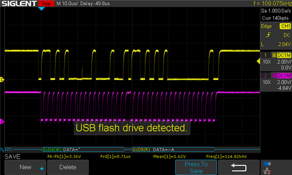

  • Hi Garrett,
    Thanks for your response.
    1) I2C is 400 kHz, 3V3. I've attached an oscilloscope shot of an I2C transaction if that's helpful. I always do readback after writing registers and don't really see issues with the bus.
    2) 12A setting resulted in the same behaviour.

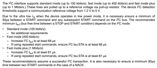

  • Hi Martin,
    Thank you for your response.
    Please allow me to refer you to section 8.5.1 Serial Interface in the BQ25628E datasheet. There is a requirement related to I2C communication when using the BQ25628E.
    When in battery only mode operation if the I2C requirement is not met the BATFET turn off behavior you observe can occur.
    Additionally, we are currently in the process of releasing a new revision of the datasheet where timing requirements are relaxed compared to the overly conservative requirements listed in the current revision. Therefore please refer to the timing requirements shown below.
    Garrett
  • Hi Garrett,
    This resolved it, thanks!!
    I think a very unusual issue / behaviour and I would have never solved it without your advice. It might be worth strongly highlighting in the datasheet just how critical the I2C timing is and that it manifests in behaviour seeming unrelated to I2C.
    Best
    Martin
