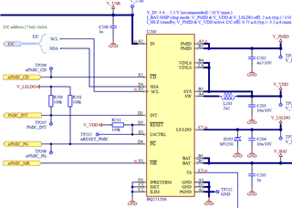

I am using the BQ25120A in a compact, portable device that has a built-in 3.7V lithium battery without an on/off switch. For this reason, and because the microcontroller used does not have a hardware reset pin, I supply the electronics via LS/LDO (operated as LS and VINLS connected to SYS) so that I can still reset the electronics by briefly turning off the LS via the control pin LSCTRL. LSCTRL is connected to the /RESET pin for this purpose and a pull-up resistor to SYS ensures that LS/LDO is always switched on together with SYS, except when a reset is manually triggered via a button connected to /MR:

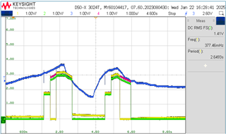

The following oscilloscope image shows the behavior of the following signals in relation to the applied battery voltage:
  • CH1 (yellow): V_LSLDO
  • CH2 (green): LSCTRL
  • CH3 (blue): V_BAT (applied battery voltage)
  • CH4 (magenta): V_SYS (V_VDD)
When increasing the battery voltage (blue), V_SYS (magenta) and V_LSLDO (yellow) switch on to 1.8 V as soon as the battery voltage crosses the default 3 V BUVLO threshold. I understand that according to Table 11 in the data sheet of the PMIC, this is an expected behavior as VIN is not valid.
During startup initialization of the device’s microcontroller, it also configures the PMIC and programs the V_SYS output to 3.2 V and BUVLO to 2.6 V.
After setting V_SYS to 3.2 V and V_BAT still rising, one can see V_SYS (magenta) trying to reach the intended higher voltage. Interestingly, V_LSLDO follows V_SYS for a very short time (not clearly visible) but then switches off completely until it is switched on again, supposedly because V_SYS finally reached the desired value of 3.2 V. This behavior is unexpected, because LSCTRL (green) always stays above the required input high threshold of 0.75 * V_SYS and I didn’t find a description in the data sheet that V_LSLDO should not follow V_SYS under these circumstances.
Then, lowering the battery voltage again, V_SYS and V_LSLDO also drop – regardless of the programmed V_SYS voltage, but remain switched on until V_BAT reaches the 2.6 V BUVLO threshold. As soon as V_BAT < BUVLO, V_SYS and V_LSLDO are switched of simultaneously as indicated in Table 11 of the data sheet.
Now, I come to the second startup sequence in the oscilloscope screen shot: V_BAT is increased quicker than the first time what seems to be the reason that V_LSLDO remains on after programming V_SYS to 3.2 V although V_SYS does not fully reach the desired level of 3.2 V (V_BAT doesn’t seem to be high enough for that).
The real disaster comes now:
All of a sudden, as V_BAT further drops, V_LSLDO is switched off while V_SYS and also LSCTRL remain switched on. V_SYS is finally also switched off but this first needs V_BAT to drop below the 2.6 V BUVLO threshold.
According to the PMIC’s data sheet one would expect that – like the first time – V_LSLDO would follow V_SYS and both supplies will switch off simultaneously when V_BAT drops below 2.6 V. However, in this case V_LSLDO switches off without any recognizable reason and the microcontroller is reset unexpectedly.

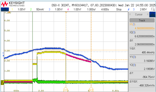

I tried some different settings like programming V_SYS to only 3.0 V instead of 3.2 V and choosing a BUVLO threshold of 2.2 V instead of 2.6 V: This, however, only changed the switching levels of the signals but not the undesired, independent switching off of the V_LSLDO output:
Don’t get confused: In this plot, CH2 (green) shows the battery current, not the LSCTRL signal.
I finally found that soft-enabling the LS/LDO solves the problem:
Interestingly, setting the bit EN_LS_LDO = 1 prevents V_LSLDO from being switched off prematurely when V_BAT drops. In this case, V_LSLDO permanently follows V_SYS until V_BAT drops below the BUVLO threshold and V_SYS / V_LSLDO are then switched off together. However, using EN_LS_LDO = 1 is not a viable solution for my device as with this, the input LSCTRL becomes inactive, and the microcontroller cannot be reset anymore in case of a hang-up. It is not clear why the behavior of LS/LDO is different depending on whether LS/LDO is operated via the LSCTRL pin or via the register bit EN_LS_LDO.
