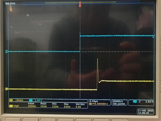

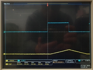

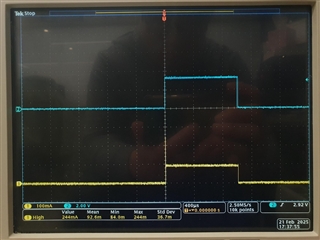

Q1) Does it not work with an external Strobe signal when operating in Flash mode and Level trigger?
The desired operation is to output the LED current only when the Strobe signal is High in Flash mode.
Q2) The datasheet states that the strobe is 1ms or longer, but is it correct that the LED output does not come out when it is shorter than that?

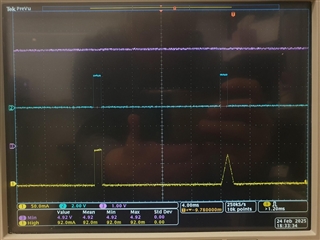

2) IR LED Mode – Abnormal operation
When setting to initial IR LED and giving pulse to Strobe, LED current is synchronized to Strobe and outputs normally.
After a few seconds, as shown below, Rising starts with delay from Strobe signal and does not reach the desired current.
Regarding the above mentioned problem, I would like to request review to see if there is a design error.
Please check. Thank you.

    Q1): According to datasheet table 7.5.1, if you need to use strobe to control the output, for Enable Register (0x01), Strobe Enable bit should be set to 1, but Mode Bits could be set to 00 or 01.
    • If set to 00, current rising/falling speed will be slow ramp.
    • If set to 01, current rising/falling speed will be fast.
    Q2): >1ms is just a recommended strobe pulse width to output a well-shaped current. <1ms strobe pulse width are also acceptable.
    2)
    This is weird.
    From the waveform, it seems that the strobe behavior is changed from IR mode to ext Flash mode.
    Also, it is possible that thermal scale-back may happen.
    IVFM may also lead to this, but it is disabled now.
    To verify this, could you please help provide read-back value of register from 0x01~0x05?
    Thank you!
    John.

    Below is the signal capture when the abnormal operation occurred.
    (R139 was replaced from 0 ohm to 0.1 ohm resistor.)
    As you can see, the I2C Line is quiet.
    Is there a clue to solve the problem?
    Thank you.
    Henry.
  • Hi Henry,
    If I am understanding correct, 'However, it is not always checked and is irregularly checked every time I test. It was not checked in other cases.' means the abnormal behavior is not every-time reproduceable? Or Short flag 1 is not every-time reproduceable?
    One of my guess is abnormal short fault happening reset the mode to standby. And read register clear that fault flag bit. But I still not sure by short happens.
    Could you please share me the schematic and layout (in altium format or gerber file)?
    Thank you!
    John.

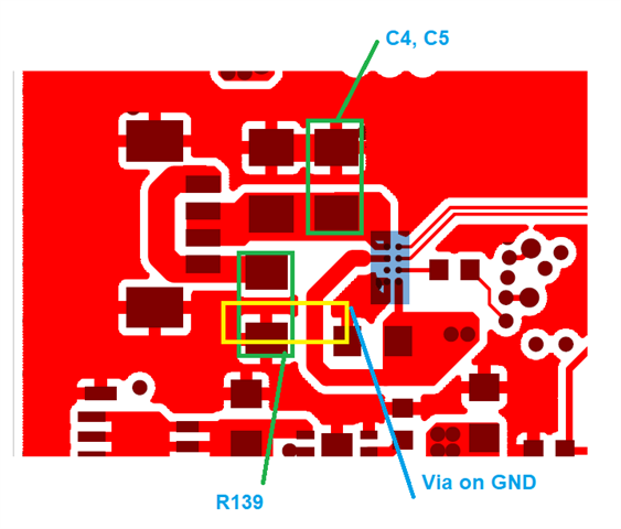

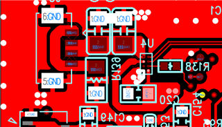

  • Hi Henry
    It is difficult to provide the entire board's Gerber files.
    Would it be okay if I provide the relevant PCB files layer by layer instead?
    best regrad
    song
  • Hi Song,
    You could send me the layer-by-layer file and I will try my best to check that.
    Thanks!
    John.
  • Hi john
    Please provide a secure email address for file transfer.
    Sharing on the web is not an option.
    best,
    song
  • Hi Song,
    Sure. Please send to john-shen@ti.com
    Thank you!
    John.
  • Hi john
    I have sent the document to the personal email you provided.
    best regards
    Song
  • Hi Song,
    Well received. Could you please help remove C4, C5 and see if the problem still exist or not? My guess is the charging of big C may trigger the short fault which reset the mode bits.
    Thank you!
    John.
  • Hi John,
    C4 and C5 have been removed, and the test was conducted in advance.
    Even after removing C4 and C5, it still switched to standby mode in IR mode.

  • Hi Song,
    Did you test circuit again with C4 and C5 removed?  and one of C2 or C3 was soldered most close to LM36011?
    It's hard to check layout in Gerber format.
    Pls check the vias placed on LM36011 and R139 GND pin, it requires multi vias to connect these two GND pin to ground plane. pls try below:
    1. cut VIN trace in Yellow area as above, connect it with short thick wire
    2. direct short two GND node in Yellow area with solder tin,
    3. check circuit operating again.
  • Hi John,
    1. I removed C4, C5, but the symptoms are the same.
    2. C2 or C3 (C20 in the attached picture) was placed closest to LM36011.
    3. There are 4 vias placed on the GND pin. Do we need to cut the VIN trace?
  • Hi Song,
    the layout looks OK.
    The transient power loss is (5V-2.9V)*1A=2.1W at 1A load. Can you test it with lower LED peak current like 200mA to see if the problem solved?
  • Hi Andy
    I tested under the following conditions:
    Schematic
    C4, C5 : Open (removed)
    R139 : 0 ohm (short)
    Register Setup
    (0x01)LM36011_ENABLE : 0x25
    (0x02)LM36011_CONFIGURATION : 0x1E
    (0x03)LM36011_LED_FLASH_BRIGHTNESS : 0x07 (About 0.094A)
    Initially, the LED current is synchronized to the Strobe and outputs normally as shown below.
    (1: LED Currnet, 2: Strobe Signal)
    After a few seconds, it still behaves abnormally as shown below.
    However, as shown below, the LED Peak Current when operating normally exceeds 300mA.
    Does the above peak current cause abnormal behavior?
    Thank you.
    Henry
