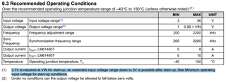

I would like to standardize the buck converter for my Ethernet switch application with the following requirements:
  • Input/Output Requirements:
    • 12V input to 3.3V output at 4A.
    • 3.3V input to 1V output at 5A.
I found the LM61480T-Q1 to be a good option in terms of thermal performance. The maximum temperature I want to allow at full load is 45°C.
However, I noticed a discrepancy regarding the minimum input voltage:
  • The datasheet specifies a minimum input voltage of 3V,
  • While Webench recommends a minimum of 3.6V. (screenshot below FYR)
Could you please clarify this discrepancy?
Additionally, could you suggest a better alternative for achieving a 1V/5A output with an IC junction temperature of 45°C at full load, while ensuring better EMI performance?
Looking forward to your response.
  • Hi Rama,
    Here is a note from the datasheet underneath the recommended operating conditions to explain that discrepancy:
    Webench is meant to emulate conditions similar to this minimum operating input voltage specification.
    The best way to achieve 1 Vout with this device is by populating RFBT with an appropriate resistor (10K is usually enough) and leaving RFBB open. This device should work for your operating conditions.
