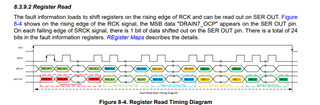

I would like to ask if the TLC6A598 has a feedback function? Can it be used with the TPIC6A596 P2P?
  •  Hi Careth,
    Yes, it's P2P solution for DW package.
    Regarding the readback function of TLC6A598. Please refer to below description. The register map is shown in the Table 8-1.
    The fault information loads to shift registers on the rising edge of RCK and can be read out on SER OUT.  There is a total of 24 bits in the fault information registers. including the over current, open or short, TSD protection information. Many thanks!
