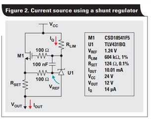

TLV431B-Q1: Current source using a shunt regulator
Part Number: TLV431B-Q1
Other Parts Discussed in Thread: TLV431
Hi Team,

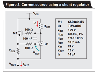

Required design calculation of below circuit and expected voltage across the 100nF capacitor.
Please have a look into the link attached for the source document.
High-side current sources for industrial applications
