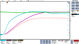

I will add an oscilloscope measurement afterwards.

  • Now the aformentioned oscilloscope picture:
    Blue: I_D
    Green: V_D
    Purple: V_S
    Red/Orange: E_FET (Integration of ((V_D-V_S)*I_D)

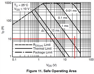

    Peak energy is 70,6mJ with V_DS,max = 24 and I_D,max = 9.9A -> t = 70,6m/24V/9.9A = 297 us ~ 0.3 ms
    SOA of the NTMFS5C410N

    Continuing the example above I measured a Pmax of 116W.
    Using the formula i get a t2 = E_FET/P_MAX = 608us -> inserting this timing in the SOA graphic and using V_IN = 24 as V_DS
    I get a current of I_SOA(25°C)=8A
    Accounting for derating that gives me a I_SOA(85°C) = 8A * (175-85)/(175-25) = 4,8A
    Concluding, I_SOA(85°C) > 1.2 * (P_MAX/V_DS) = 1.2*(116/24) = 5,8A is not complied with.
    Could you confirm this calculation is correct that far?
