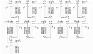

I am working with a chain of 11 TLC59711 IC's, my issue is when I turn on the pwm for 1 it is turning on the rest of them.
For example setPWM(1,65535) // FULL ON, will turn on 13, 25, etc (Which is the 1 for each chained IC)
Configuration
Arduino UNO SMD
Schematic
Code
