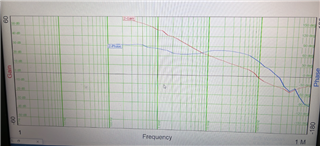

TPS40090EVM-001: Why can’t I measure the same CLOSED LOOP BODE PLOT in TPS40090EVM-001?
Part Number: TPS40090EVM-001

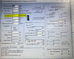

The following are the measurement tools I use.
Is there an error in the measurement connection method? Or is there another problem?

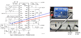

Measurement circuit:TPS40090EVM-001
Measuring Bode Plot equipment: Venable Model 6305

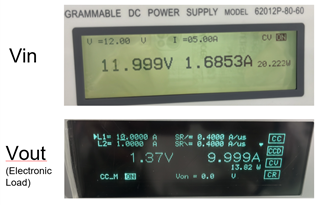

Power supply: Chroma 62012P-80-60
Load: electronic load  C.C : 10A
Vin : 12V Vo :1.37V  Iout : 10A

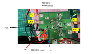

    You are injecting 100 mV between FB and VOUT which is a lot of current for the converter to match. I would recommend setting the injection level to 10mV and see if that helps the bode plot.
    If this does not help, please send pictures of the connection from the injection isolation transformer and the oscilloscope probes.
    Maha
  • Hello ,
    Thank for your reply.
    I will change it to 10mv and do it again,
    But there is still no improvement.
    The injection isolation transformer is connected using BNC to alligator clips.
    Best Regards , Jun
  • Hi ,
    Later I found out that there was a problem with the 1:1 transformer, so I replaced it and the problem was solved.
    Thank you very much for your help.
    Vin = 10V Io = 5A
