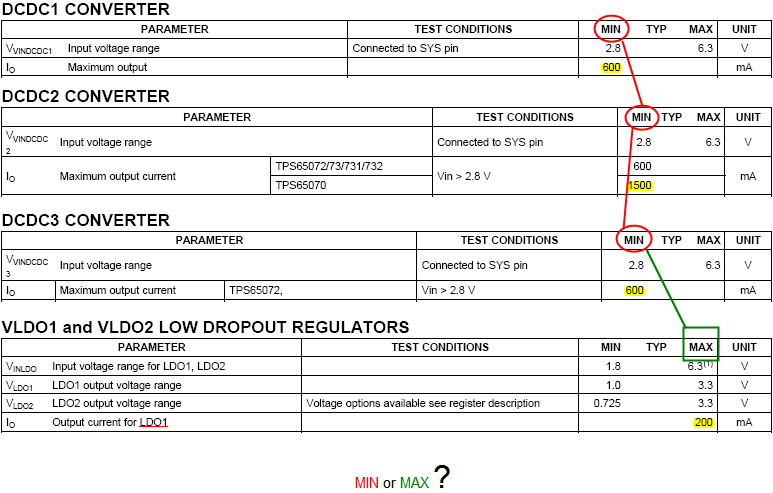

I would like to ask a question on TPS65070.
In ELECTRICAL CHARACTERISTICS of TPS65070 datasheet SLVS950C, the current for each converter and LDO are listed. However, I found that for all three DC/DC converters, the maximum IO is listed only "Min" value, whereas for two LDOs the maximum IO lists "Max" value.
Since it is about the maximum current output ability, I think it is more reasonable for all the value to be under "Max" column. So for the three DC/DC converters which has output under "Min" column, is it a mistake of the datasheet here?

  • The DCDC converters can output at least the minimum specified current, where as with the LDOs you cannot draw more than the max spec.

    Even when the CPU and the system is in standby or deepsleep mode, does the DCDC converters still output AT LEAST:
    DCDC1: 600mA
    DCDC2: 1500mA

    Now each DCDC can output at least the below amount:
    DCDC1: 600mA
    DCDC2: 1500mA
    DCDC3: 600mA
    These are in the "Min" column; But isn't there an upper limit? For example, not to put extremely unrealistic figures like 5A or 10A, but isn't there "Max" upper current limit measured, say, like 1.8A or 2A? I guess this must exist.

  • Zhao,
    The max is not specified 1) because it is dependent on a number of external factors and 2) to keep the datasheet simple
    The min is specified using either minimum or typical values as set in the recommended operating conditions table.
    Please provide information about the application.

    Thanks for the explanation on max value. This question is resolved.
