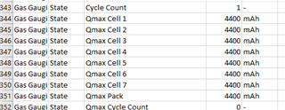

    Thank you for the confirmation, can you please try altering the current Qmax values prior to the charge to the set 750mAh seen for the design capacity? I would like to see if this is occurring due to a large change in the Qmax value.
    Anthony
  • Hi Anthony,
    I tried doing the same but still no luck. Please find the log below. Another interesting thing about the log is capacity calculation. As you can see in the log, the charging started when the Remaining Capacity was 2 mAh and charged till it equalled the "Calculated" full charge capacity of 706, and the charging continued even after both of them were equal. However as soon as I hit VCT, the full charge capacity dropped to 620, even though the gauge itself calculated that it gained more than 620 mAh throughout the charge.
