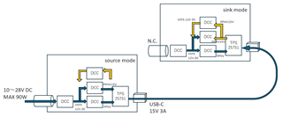

  • Hi Raymond,
    In sink mode, it would be great if the 45W PD power could be pass-through to the system power supply.
    The goal is to distribute power from one DC power source to two devices.
    I am wondering if it is possible to feed power from the source mode to the sink mode (they have the same circuit) with a PD as shown in the figure.
  • Hi Yamazaki-san,
    Is the intention for TPS25751 to control TPS55289? Or is there a MCU that will handle the I2C configuration for TPS55289 based on the negotiated PDO?
    At this time TPS25751 does not have the integrated support for TPS55289, the only integrated I2C control embedded in TPS25751 are the BQ battery charger listed on the datasheet and the GUI.

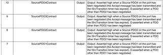

    Another possibility is using TPS25751 GPIO events to configure a DCDC Feedback pin. You can configure TPS25751 GPIO pins with these events to toggle when a specific source PDO has been negotiated.
