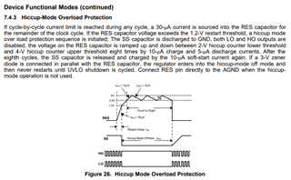

    However, there is one additional feature called hiccup overload protection.
    This feature will actually turn of the device for a certain period of time after cycle-by-cycle protection is triggered for several times in a row.
    It is described in the datasheet:
    Please let me know if you have additional questions on this feature.
