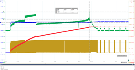

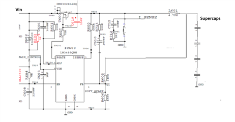

our customer Forvia is using LM3489 to charge a supercap (4x25F in series)
Vin=12V
Vout=10V
Iout=8A

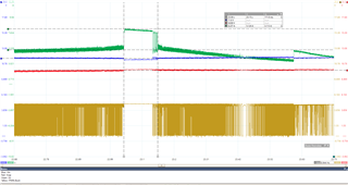

Below is the test result waveform of the Buck converter (LM3489QMM). When the output voltage reaches approximately 10V, resulting in a 100% duty cycle. However, the expected current limiting behavior is not being observed in this scenario.
The Mosfet used https://www.diodes.com/assets/Datasheets/DMP3028LPSQ.pdf is 28mOhm typ.
Why is the current limiting function is not working when the MOSFET is fully on with a 100% duty cycle?
