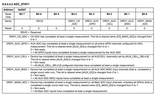

I have a question regarding the ADC_STAT1 register (address 0x0527) on the BQ79631-Q1.
When reading this register, I observe that Bit 4, which is marked as RSVD (Reserved) in the datasheet, is set to 1.
The value I read is 10001, whereas I would have expected 00001 based on the documentation.
Could you kindly clarify whether this behavior is expected and if we can safely ignore this bit during normal operation?
Thank you in advance for your help!

  • Quentin,
    I have one follow-up question: Could you please provide the exact meaning of this bit for completeness?
    According to the documentation, RSVD is described as follows, which does not fully align:
    Reserved. Reserved register addresses or bits are not implemented in the device. Any write to these bits is ignored. Reads to these bits always return 0.
    Looking forward to your insights!
    Stefan
  • Stefan,
    Could you please show me exactly how you are reading this and the result?
    I want to make sure this is a real result.
         Quentin
  • Hello Quentin,
    As requested, here is the specific request and corresponding response.
    Below that, you’ll also find the complete trace from wake-up onward.
    This trace was captured on a test setup using a BQ79631 (BMS039A / BQ79631EVM-039) as the base device and five BQ79616 devices in a daisy-chain configuration.
    Stefan

    TI COMM OF INTEREST BEGIN
    TI COMM TX (before RX): length=7 data=[80 00 05 27 00 2E 2F ]
    TI COMM RX: length=7 data=[00 00 05 27 11 EF FD ]
    TI COMM of INTEREST END
  • Stefan,
    I got to the bottom of this question.
    This bit is actually the DRDY_CS_ADC bit. The table must have been copied over incorrectly from the BQ79616 datasheet instead of the BQ79656 datasheet.
    Please refer to the corrected table below.
         Quentin
