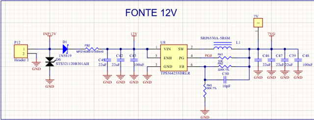

Hello everyone,
I am having a problem with the TPS564255DRLR, but I’m not sure if this is the right channel to ask for help.

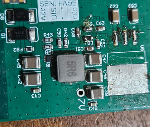

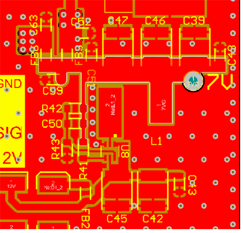

I produced 5 prototypes using the TPS564255DRLR, but only one board is working as expected.
Initially, I reviewed the assembly and the values used, and everything seems correct.
All 5 chips were purchased from Mouser and came properly packaged.
The chips that are not working show absolutely no DC voltage or signal on the output — they simply do not run. On the other hand, the one that works did not require any changes to the assembled values.
I would appreciate any suggestions. Thank you!
